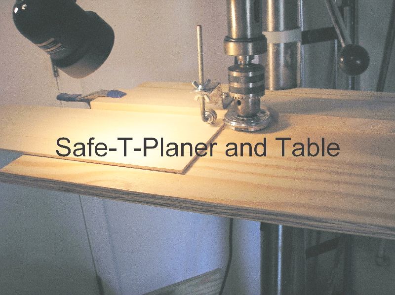

PostPosted: Sun Jan 15, 2006 2:40 am
Here is my set-up with the Wagner.I really like this tool
PostPosted: Sun Jan 15, 2006 3:00 am
Posts: 778
Location: Madison, WI
Nice table set up, Dave.
-jack handy
PostPosted: Sun Jan 15, 2006 3:39 am
Dave Andy, hey, this is why I come to the OLF, just when you least expect it, someone comes up with a revolutionary idea like the little J-hook bearing roller hold-down thingy. That is super. I'm putting this on two jigs now, my Router Planer and my new Wagner Drill Press Planer.
Saved the pic into my A Shop Ideas folder and it's mine all mine. AAAAhhhhhaaahaaa! Thanks for sharing, great jigging by the way. (sorry for the Jeckel moment)
PostPosted: Sun Jan 15, 2006 5:02 am
Thanks guys , the bearing hold down thingy is not my idea though, but came from from a Stew-mac sheet I think. It is a neat idea and works very well.
